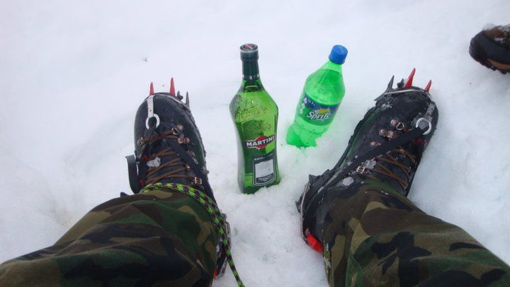

In winter or up high, we use issued Scarpa Invernos technical boots. They are surprisingly comfortable and multipurpose! You can walk on normal terrain in the forest and forget you are wearing a plastic boot.
They are crampon compatible, and in a pinch you can attach them to Diamir ski bindings.
Scarpas. Miartini for scale.
Scarpas. Martini for scale.
