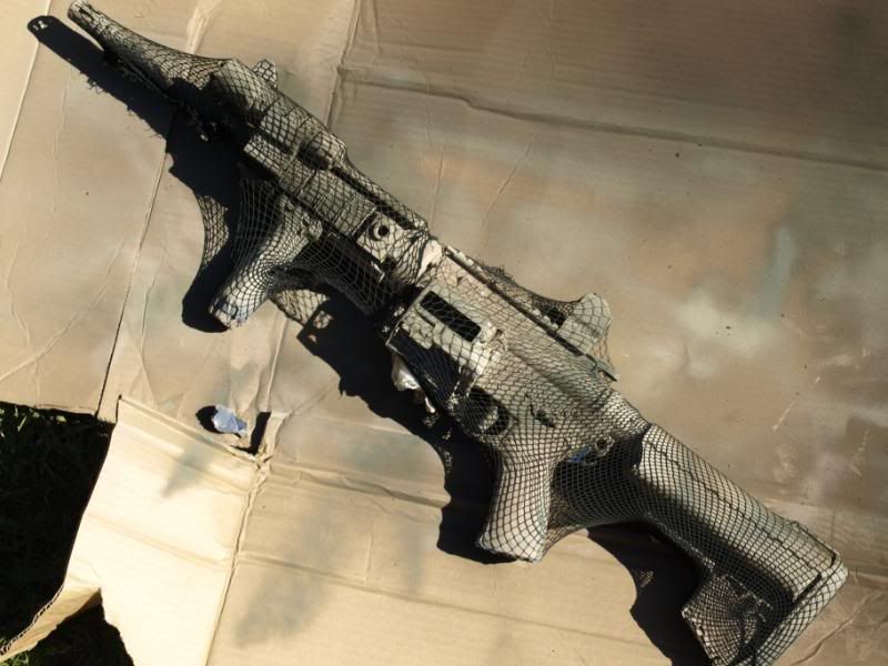

Also, for a stencil -and don't smirk --fishnet stockings. The stocking material will stretch around the gun, (you can use one leg per gun, if you want) it is terrific at varying the pattern of stencil, which aids to further break up outlines.
YMMV.
Close-up of the effect:

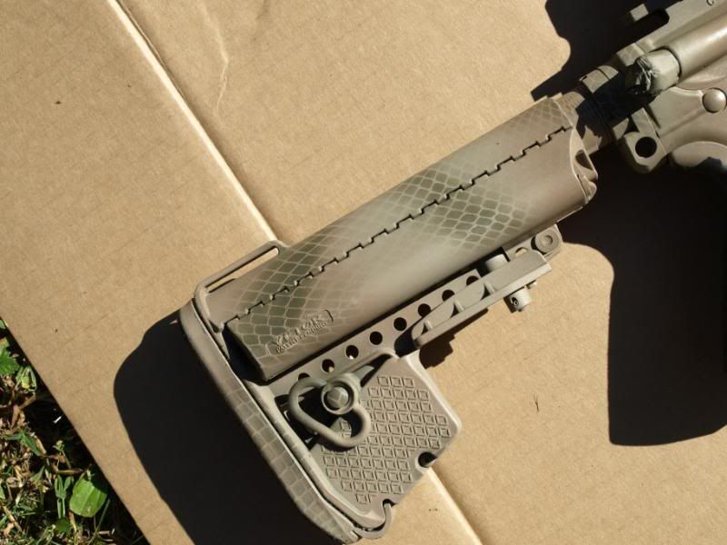

Nature doesn't have blobs --it has rough, scratchy, semi-obscured blobs. Brown soil, behind green grass and jagged dry light brown leaves.
This does the saame as any other netting or mesh -except this has varied widths, vs. uniform widths of a mesh bag. Same effect, more variety.
And -it looks like snike skin, so I like that. Personal preferance. 'Any break up helps the makeup'.

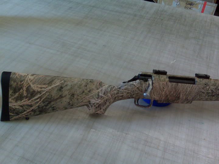

I've got a friend who works for a gun manufacturer and he applies a camouflage coating to guns.
Example:
Would this be something I would want? It looks excellent, but I have no real experience in judging effectiveness here.
