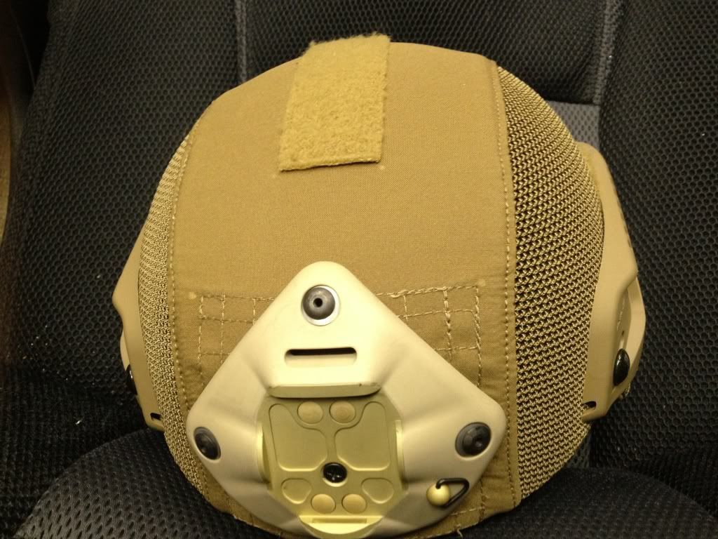

So I'm finally getting around to posting pics of the Multicam First Spear ACH cover. Took forever to arrive then life got busy.
Cover is a size Large on a size Large helmet. I had previously painted the helmet so it has a tan base coat under the mesh area.
The cover attaches via multiple velcro straps as well as a shock cord liner around the edge of the helmet. It will require your helmet to have velcro on the inside, and the straps from the cover are double sided so any pads you may run just stick right back over the helmet straps.
As has already been mentioned, the side velcro is covered by ARC rails. I pocked a tiny hole in the cover for the NOD bracket and ARC rail screws.
Any questions or more particular photos of something, let me know and I will try to help.

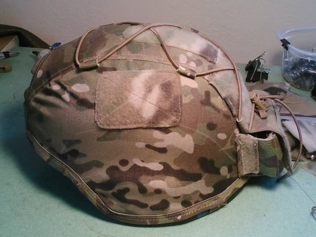

Latest cover enroute to South America, bungee loops and rounded velcro edges by special request, single MultiPurpose Pocket on back that can be used for MS2000 Strobe or as Counterweight/Battery Pocket, has the strobe switch slot sewn in, inside covered with velcro when not used, left side is MC Omega Mesh with a 2" MC webbing flap that folds back onto itself to allow the strobe signature to emit thru the mesh. Side velcro placed above ARC Rails:
I used Multicam woven elastic for the battery card, just hope he doesn't lose it in the jungle.
I changed to using 1" MC printed edge tape along the rim, double stitched, for speed of mfg, stronger mount point for the attachment fingers and better conformance to the rim curves.
And, I've started to use tan Velcro OneWrap for the attachment fingers, bartacked to a short length of 1" binding tape, so there is no exposed velcro on the rim to catch on everything when it is set down. Speeds up construction, saves time gluing both velcro parts to the edgetape then sewing around the edge. And it rolls up onto itself to prevent the fingers from sticking to everything as it is being made or installed on the users helmet.

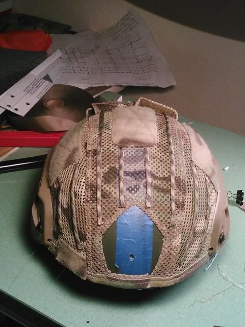

Yet another custom, Omega Mesh, NVD Porthole, side velcro above ARC Rails, 2" wide MC printed "mohawk", and, my newest integral MS2000 Strobe/Batt Counterweight Pocket, that snaps down over your goggle strap.

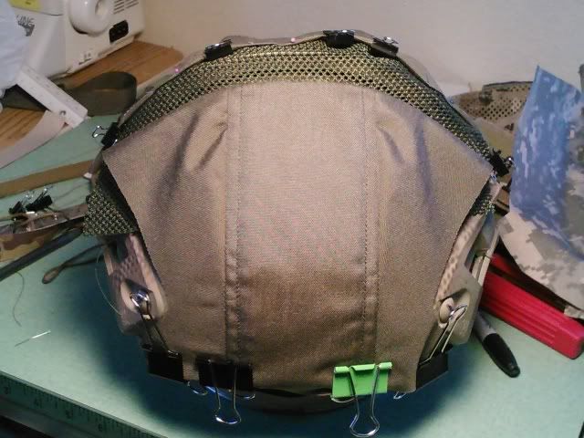

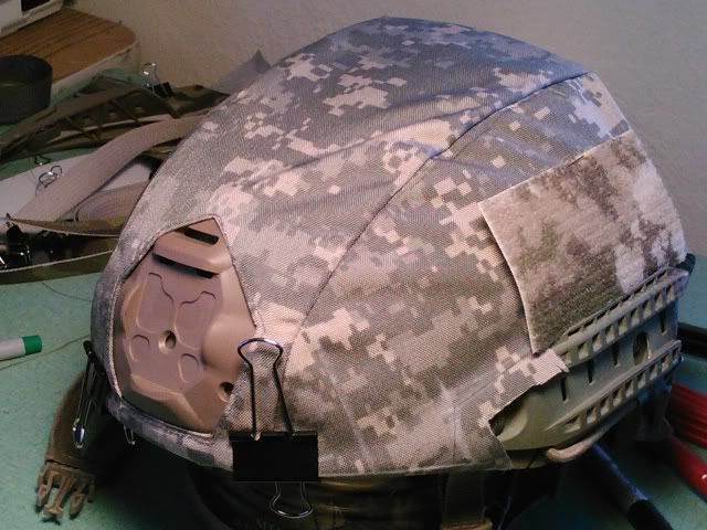

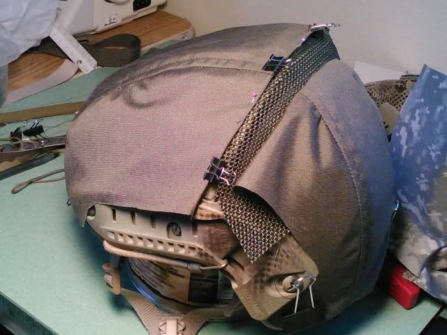

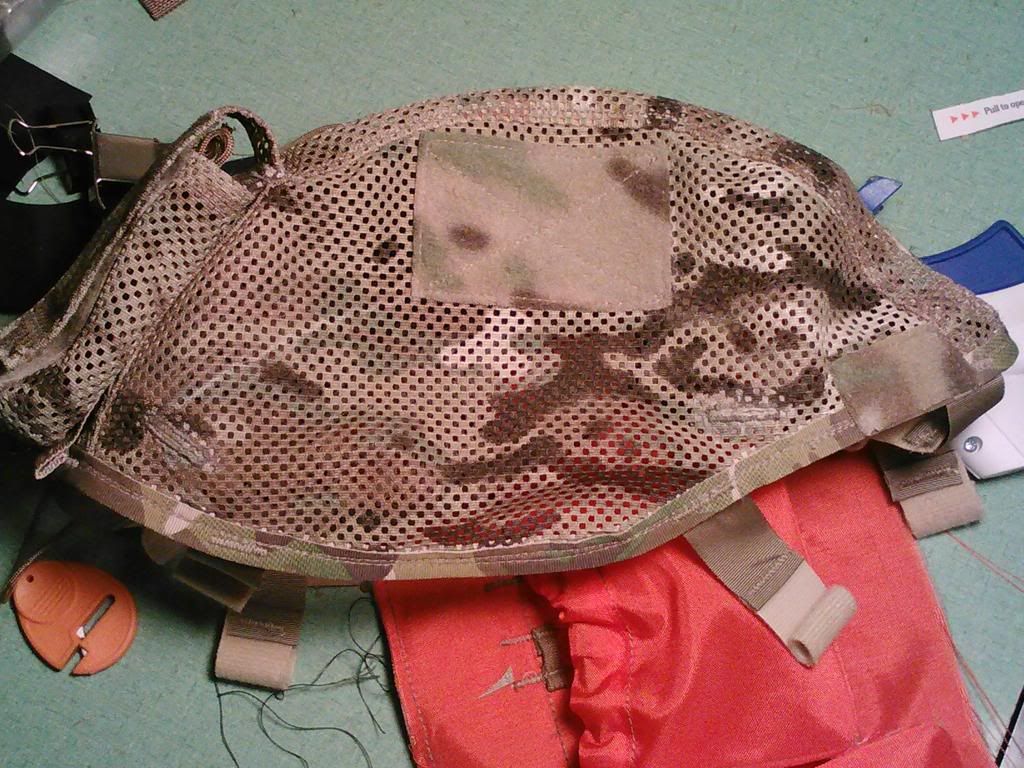

By special request,these Airframe covers have Mil C 8061 nylon mesh being sewn in to cover the shell vent, to keep out bugs and to minimize hot secondary junk from burning your scalp.
This rush job UCP (may a pox be upon that Natick project manager forever) Airframe cover, foliage green vent screen and, just for aesthetics, ATACS-AU printed velcro for the side patches:
The Airframe is a bit of a pain, you actually have to make two covers for it, and, trying to hold the material in place between the two shells,

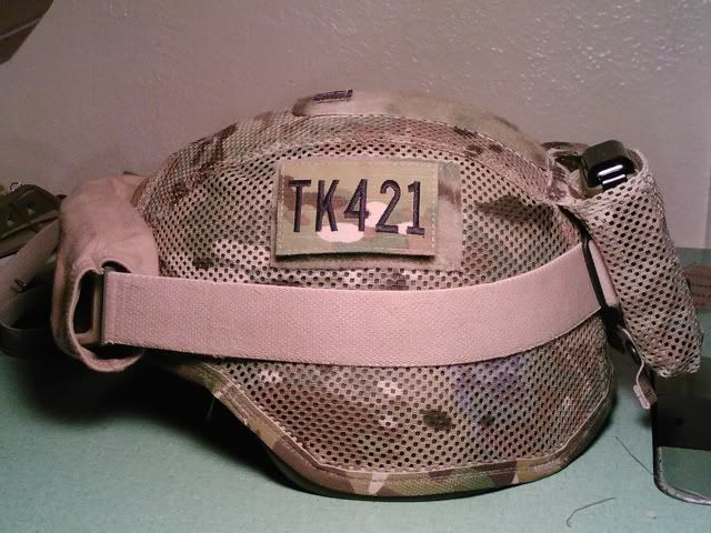

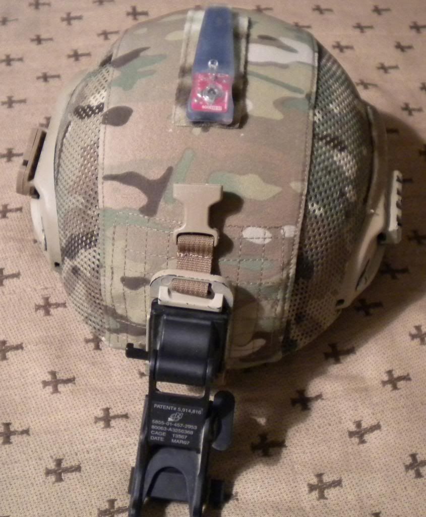

Nothing as highspeed as falldownjaeger's work, but I modified an issue helmet cover. I had a similarly modified helmet cover for the deployment to slap a helmet camera for AARs and stuff, but this time I went full retard since it's my personal brain bucket:
Battery pouch is a (modified with extra velcro and an easy grab strap) BFG BooBoo pouch on two sewn-on 2" Multicam webbing strips. It's the perfect size for an ANVIS pack, who knew?

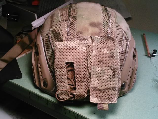

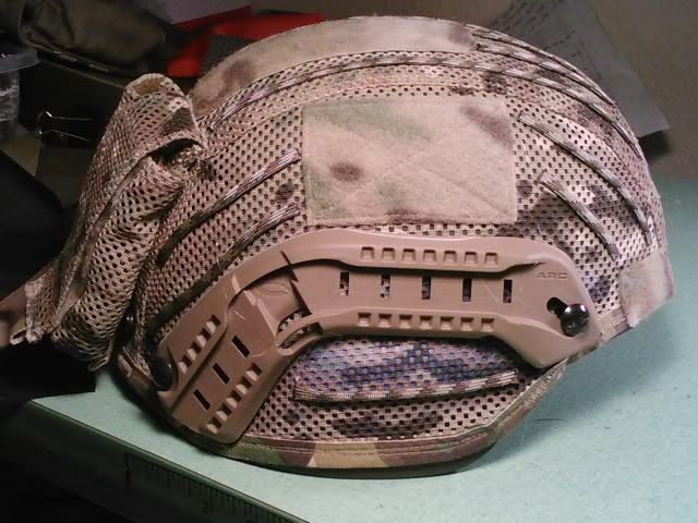

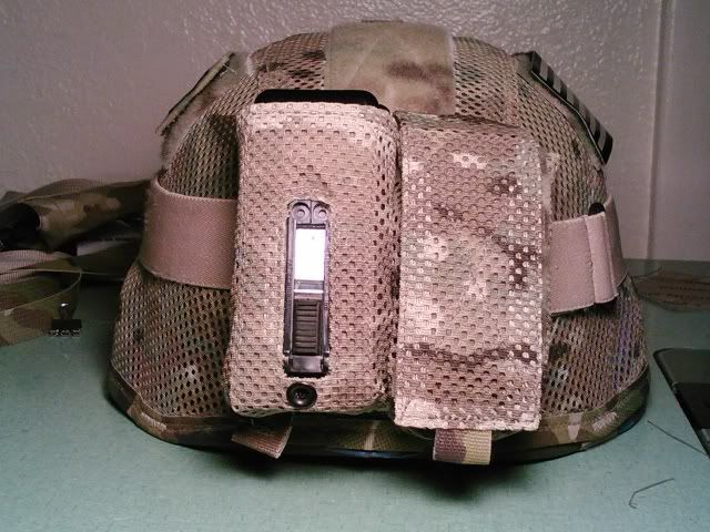

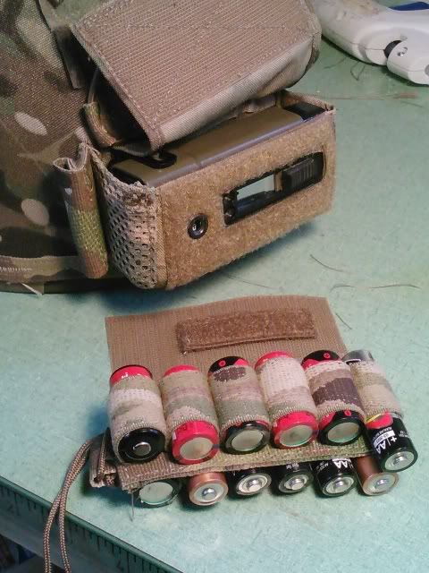

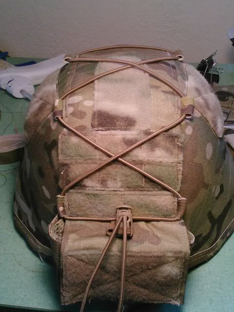

Just finished, open top MS2000 Strobe Pocket (by special request) and Battery/Counterweight Pockets are on their own backing secured by two Scovil 24L blackened brass mil spec hard action snaps to act as a goggle retainer.
Intended for ARC Rails to be bolted overtop, has the chinstrap/rail bolt holes run as buttonholes reenforced by 725d Multicam nylon to prevent holes from tearing, egging, etc. Buttonholer itself was an ordeal finally overcome.
And, for light infantry use, gutted Multicam 550 cord run as garnish loops, temp tacked in place in this pic.
Attachment fingers are now made with tan Velcro OneWrap bartacked on edge binding tape.

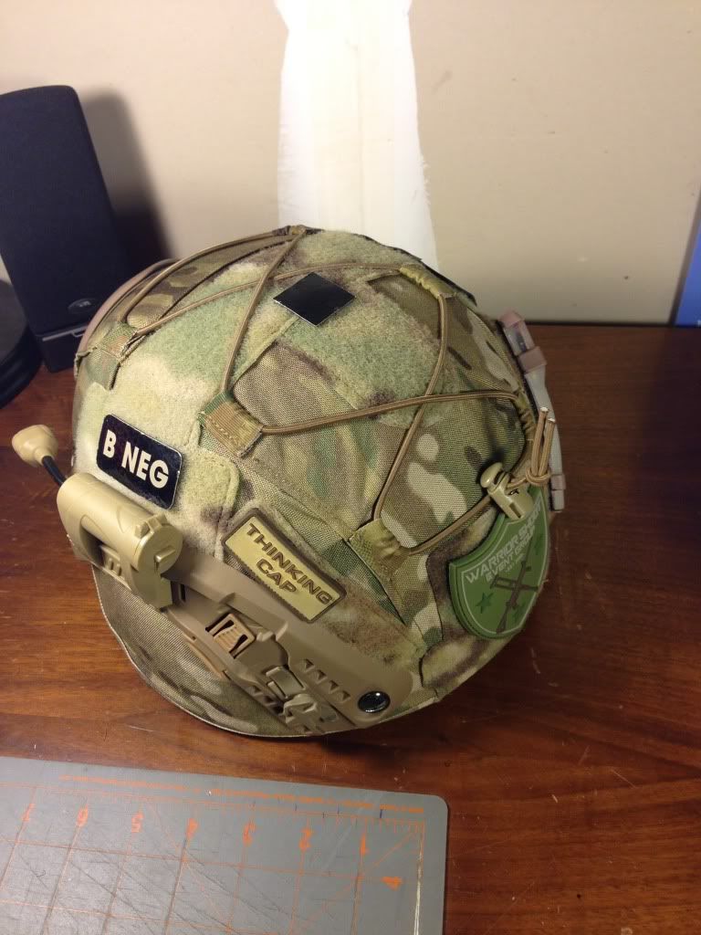

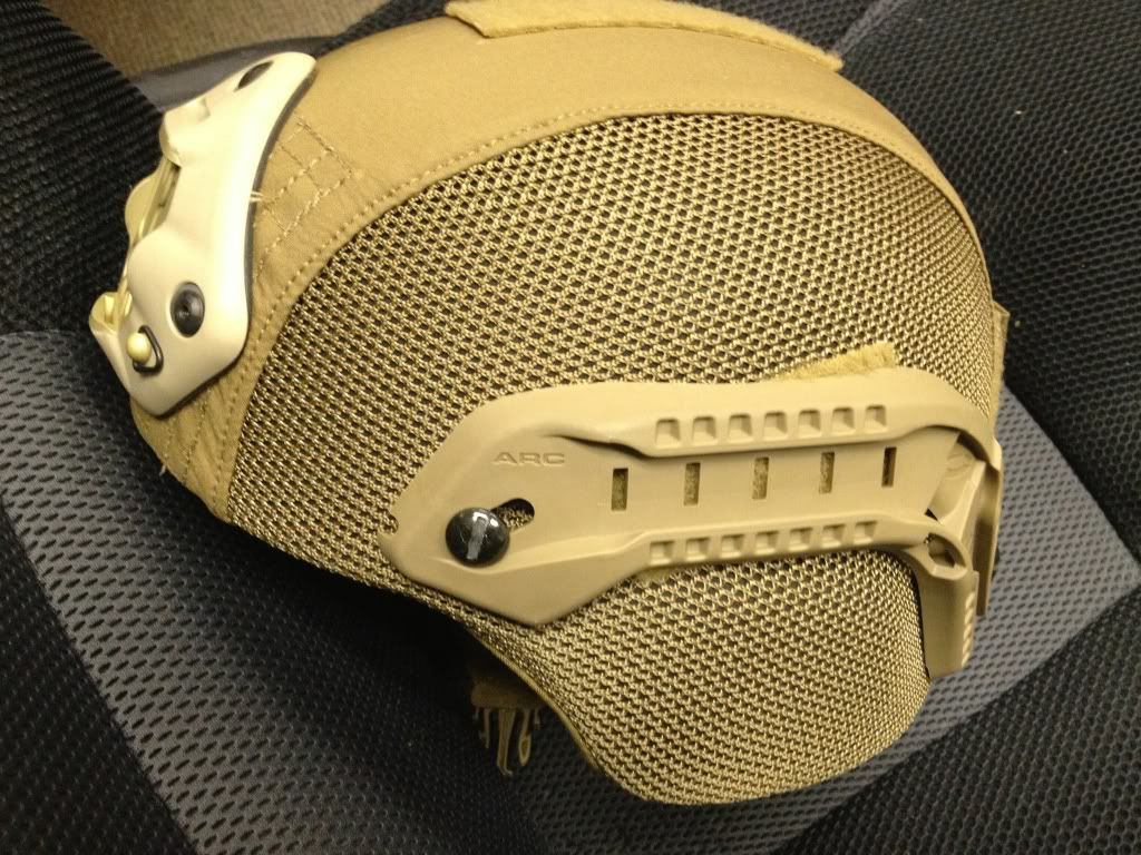

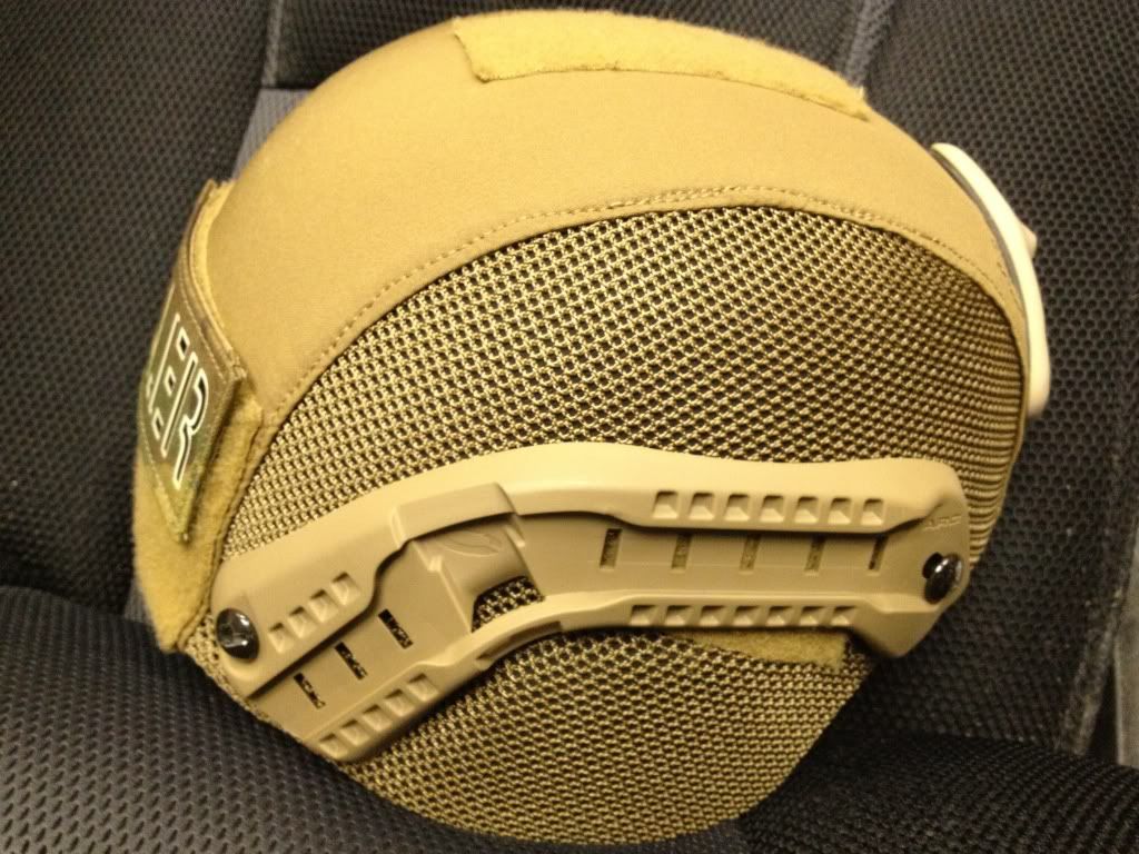

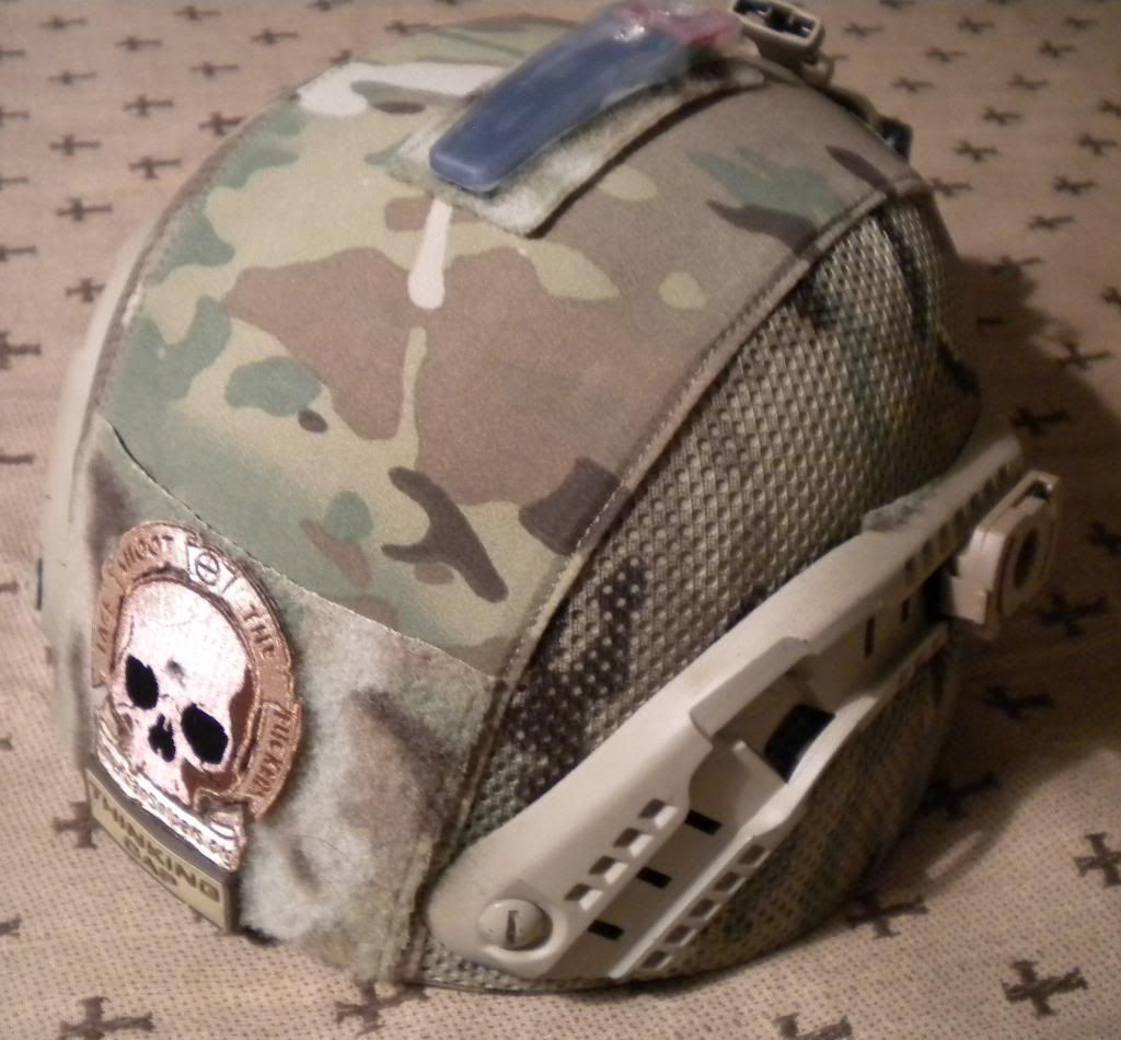

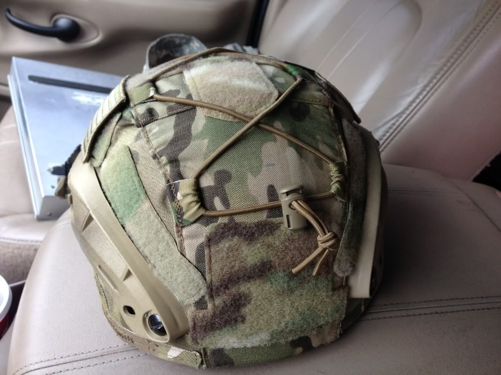

My current iteration of my Ops Core helmet:
It's a regular Ops Core FAST cut, with Ops Core H-Nape and Team Wendy pads. The helmet cover is the Combat Kit Infantry cover. The light is a Princeton Tec MLPS.

Actually...I did a story for SWAT on the BooBoo Pouch a year or two ago, and showed one that I had attached to my Airframe.
This takes nothing away from your work, which is clearly Top Shelf.

You make some seriously sick kit brother.
