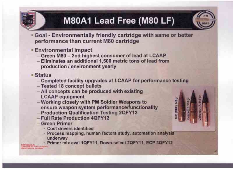

Friend of mine is down at Benning (has an account here but hardly ever posts) testing new equipment. He said they shot a bunch of this out of some AMU built DMRs that were being tested. He did say it shot noticeably flatter than M855.
LGOP: a small group of "pissed-off American paratroopers" who are well trained, armed to the teeth, and lack serious supervision. They collectively remember the commander's intent as, "March to the sound of guns, and kill anyone who isn't dressed like you ..."
It will work like a Barnes X bullet or the TSX style bullet. Weight is the same, so it will be longer, and likely have a superior ballistic coefficient. It may drift more with wind but will likely drop less if the velocity specs are the same.
Not being an FMJ, it may also be more accurate as a side effect of the manufacturing process improving consistency of the base. How it expands/fragments will depend on the design.
All gilding metal and all copper bullets (even sintered ones) have been pretty well established in the hunting and reloading markets for awhile now.
Now that I have seen a side-by-side of these two bullets I am very hopeful. I agree with the quote above that BC will be higher while weight should be OK. The penetrator should be straighter in the jacket.
On deceleration in tissue it may want to trade ends as the aft end's inertia wants to tip (lead would have been better), causing a break at the tip/jacket or cannelure junctions.
I hope and pray the accuracy problem they had with the sintered tungsten and bismuth-tin versions have been corrected –– we've known as far back as 2005-2006 that accuracy could be poorer than average Green Tip (documented and verified at the Basic Training Brigade, Infantry Training Brigade, and the AMU, all at Benning).

FWIW here are my chrono results for the SOST round.
90degF, 85% humidity, 900ft ASL, CED M2 chrono 10' from the muzzle:
12.5" 1:7 5.56 barrel | MV 2774 | SD 17.7 | ES 59
14.5" 1:7 5.56 barrel | MV 2888 | SD 13.7 | ES 36
Neither MV figure is corrected back to the muzzle.
