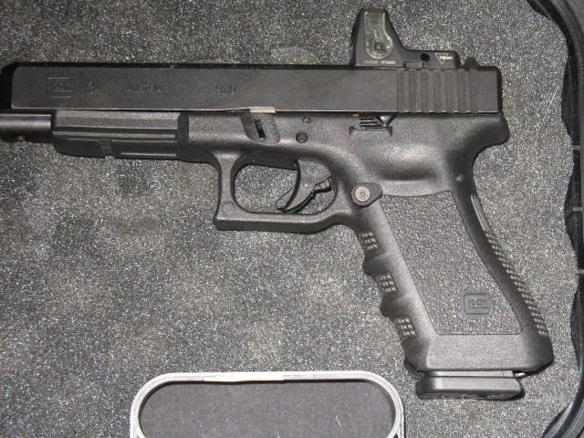

I saw a similar setup on a local pd's gun with the doctor optic, and had the same idea, so I tried it thinking along the same premise of red dots on rifles, speed, faster target acquisition, so far I'm impressed getting use to tracking the dot under recoil, and should have gotten the smaller dot but being able to hit a steel silhouette at 125 meters with a pistol is very confidence building in this particular setup, I like it ,work was done by one source tactical, great job and lightfighter is a great site
Glock 34 with trjicon RMR, dual illumination 8 moa dot

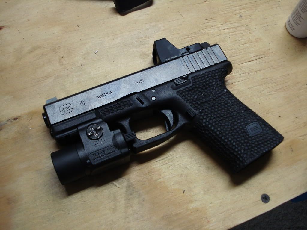

Here is my current carry setup:
At first I was slower with it, but after 2-3k rounds, I am to the point where I just bought two more RMR's for my G34 and G21. I just cant see using irons anymore, this is just much quicker. There is definately a learning curve, and I am just now starting to see the real benefits of it. I am still slightly quicker with irons, but way more precise with the dot. I dont think it will be long before my speed catches up and surpasses that of irons. Still the biggest drawback is acquiring a sight picture on presentation. There is no frame of reference, you either see the dot or you dont. With irons, you can always see the relationship.
A couple of other notes:
Battery life is good. I keep this gun in the safe, so most of the time, the dot is dimmed all the way down. I will probably replace every year.
I have a 4MOA dot on this gun, my next two will be 8MOA, and eventually I will move the 4MOA to something else and have all 8MOA.
If you get crud on the inside of the lens (Where the dot projects), its a big deal (Say full of mud or dirt). Then you have no dot and no irons. Its also fairly hard to clean out.
If you get mud on the outside of the lens, its fine, like shooting an aimpoint with the front lens cap on.
The biggest drawback I see is drawing a gun thinking the dot is on. If the dot is dead for whatever reason, it messes with your OODA loop. Because you either see the dot or you dont, you spend precious time looking for it until you realize its dead and revert to irons. Close in, its probably not a huge deal since you can ghost the shot, but farther out it may be an issue. I always check three things when I put this gun on. Chambered, light, and dot.
The RMR is incredibly robust, it makes one handed manipulations much easier, ive racked it on barricades, tables, holster, heck you can even do it in soil if you have to. It will take a beating.
I have had no issues carrying it, doesnt print anymore than a regular gun, isnt any heavier, and doesnt dig into me. Off the shelf holster selection may be difficult.
Overall I am happy with it as evidenced by buying dots for all my glocks (except the 26). I will get even more exposure and hopefully be just as happy with them as I am with this one.

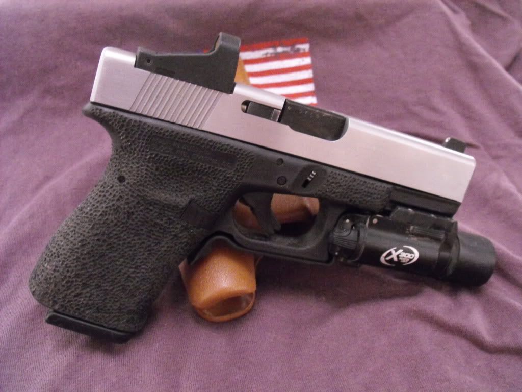

Below are some Glocks with 8 MOA RMR’s and tall Ameriglo suppressor type back-up iron sights milled by Mark Housel of L&M Precision Gunworks in Prescott, AZ:
