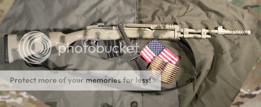

Some good stuff in this thread. This is my asshole attempt to paint my mini 14.

Well, no one can say you don't have guts, posting a Mini-14 on the Stud-Board. Actually, depending on the environment, the camo will probably work fairly well.

Hey, I like my mini 14. This is what happens when you have too much discretionary fundage. As for my profile, what in the world do you want me to put on there? A blood sample? Big Grin

And lay off my mini. Can your AR do this?

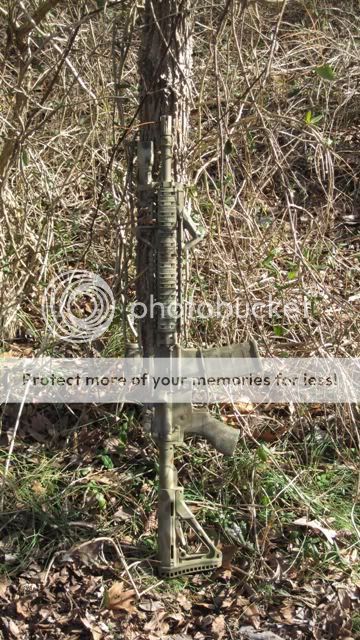

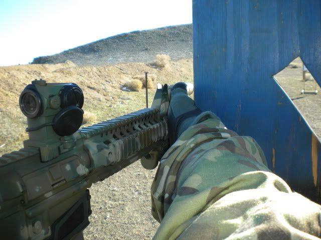

I've made several changes to my rifle so it was time to repaint it. First, the changes:
  • Replaced Surefire G2 with a G2X Tactical - although the Surefire website says they are the same diameter they are not so I had to add a rubber spacer (inner tube) for it to fit in my Gear Sector mount. This 200 lumen light is much brighter than the old G2.
  • I moved my Gear Sector QD mount closer to the receiver.
  • I replaced my Aimpoint Comp M3 in a LT129 with a T1 in a LT751; this saved quite a bit of weight and I prefer the T1 over the Comp M3 but then who doesn't.
  • I replaced a slick Ergo-Grip with a Tango Down BG-17. I stippled the grip before installing it as I thought it was a little slick on the front strap and back strap.
  • I replaced my MOE stock with a CTR for a better lock-up.
    Below are two pictures in my AO. I repainted based on The Book of Pat but first I stripped the old paint with non-chlorinated brake cleaner per Duke's advice. I'm very happy with both the changes and the new paint scheme. My goal for 2011 is to shoot the thing much more.

    Originally posted by Rosco79:
    The top one i tried using Duke's fishnet idea (the wife's face when I asked to have one was priceless) and the bottom is a laundry bag. Nice for comparison.
    laundry bag idea looks better than the stocking method. Good job.

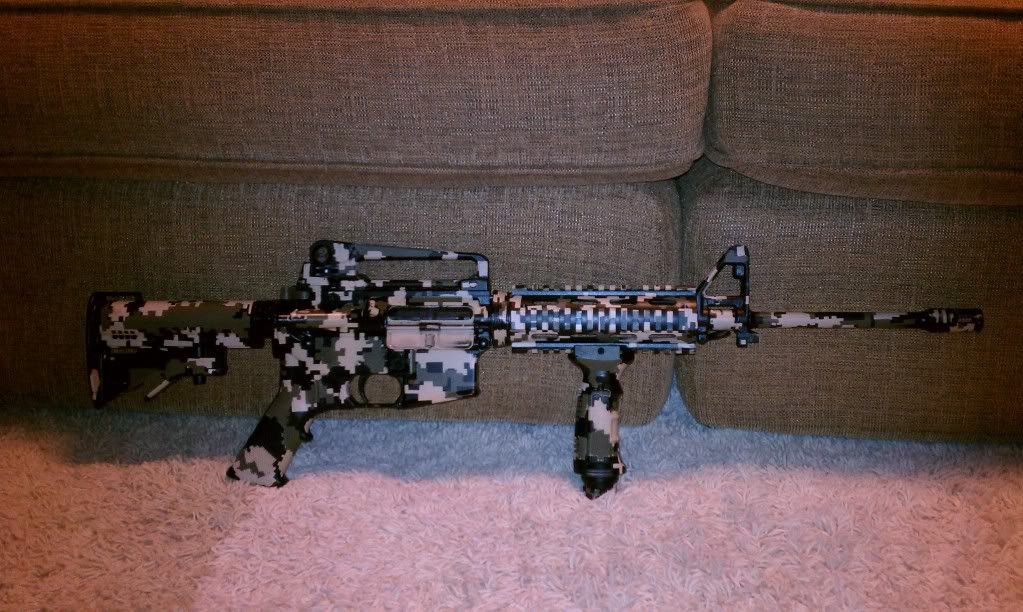

    This is my plinking AR. I had to put the logo side against the couch to prevent getting banned for owning this brand Wink
    It was my first AR. I bought it before I learned who makes the good stuff. I figured I would try my hand at painting it since i don't give a shit about it.
    I used Alumahyde II and stencils I got from Brownells. It came out ok. My crappy photography doesn't do it justice. The clear matte finish really brought it together. If I had the paint job to do over again I would have used less black and smaller blobs.

    Why is the pistol grip so far away from the trigger well? It looks like it has a touch of the syndrome. I know it's your plinker but it hurts. I hope you take some examples out of this thread and hook up your BCM build with a paint job worthy. Good luck Bro.
    No seriously, HOW does one get the pistol grip so far away from the trigger?
    I honestly did not know it was possible. It looks like a Saiga rifle with a stock and a pistol grip - without moving the pistol grip forwards. How does that happen with an AR?
    (Note, this is coming from someone who has only shot factory AR's and never put one together himself)

    He's using something from brownells called a grip adapter. It's manufactured by a company called Armstech. Here is the link to the device used to make his grip look long
    http://www.brownells.com/.aspx...TE_PULL_GRIP_ADAPTER
    In all honesty, I don't see a reason for it, but to each his own, I guess. I just figured one could bend and adjust their finger accordingly for proper trigger placement.
